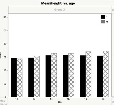

When I make a bar graph I have changed both bar colors to gray but made one pattern hash marked. However the pattern change is not reflected on the legend. How can I fix this?

Here is my example.  Does it work on your copy of JMP.

Thank you for your help but unfortunately that didn't work either. The legend shows a change in color but not pattern.

I was able to get version 15.1 and still have the same problem.
