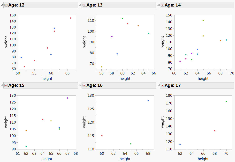

Is there a way to use the wrap functionality of graph builder where all graphs share a common x axis (time), but have differing Y axis scales?  I tried the Page option which is OK, but I'd prefer a grid of graphs.  Here's an example where one of the graphs throws the scale way off for the other graphs.

I've done this sort of thing, still looking for something better though:
Names default to here( 1 );
dt = Open( "$Sample_data/Big Class.jmp" );
//Window to hold graphs
win = New window("Graphs",
	lub = Lineup Box( NCol( 3 ) )
//List of graphs to make
ages = ( Associative Array( Column( dt, "age" ) ) << Get Keys );
//For each graph
For( i = 1, i <= N Items( ages ), i++,
	//Add graph to the lineup box
	lub << Append( Graph Builder(
		Size( 300, 300 ),
		Show Control Panel( 0 ),
		Show Footer( 0 ),
		Variables( X( :height ), Y( :weight ) ),
		Elements( Points( X, Y, Legend( 3 ) ) ),
		Local Data Filter(
			Close Outline( 1 ),
			Add Filter(
				columns( :age ),
				Where( :age == ages[i] ),
				Display( :age, Size( 224, 126 ), List Display )
		SendToReport(
			Dispatch( {}, "Graph Builder", OutlineBox, {Set Title( "Age: " || char(ages[i]) )} ),
			Dispatch( {}, "graph title", TextEditBox, {Set Text( "" )} )
//Hide all of the data filters
(win << XPath("//OutlineBox[@helpKey='Data Filter']") ) << Visibility("collapse");

It occurs to me that Peter's original question was about Graph Builder and I gave a solution using Fit Y by X.  If you need Graph Builder functionality, it turns out you can also use Fit Group() with Graph Builder output using a By variable:
Fit Group(
	Graph Builder(
		Size( 300, 300 ),
		Show Legend( 0 ),
		Elements( Points( X, Y, Legend( 1 ) ), Smoother( X, Y, Legend( 2 ) ) ),
		By( :age )
	<<{Arrange in Rows( 3 )}

Thanks @ih that's kind of what I was looking for.  Your solution is general enough I could adapt it for my uses.

It's not obvious, but if you wrap a call to Bivariate() with a By Variable in a Fit Group(), you can take advantage of << {Arrange In Rows()}, both interactively from the Fit Group Red Triangle, and in scripting:
Fit Group(Bivariate( Y( :weight ), X( :height ), By( :age ) ),<<{Arrange in Rows( 3 )});
I hope this helps!
Fit Group(
	Graph Builder(
		Size( 300, 300 ),
		Show Legend( 0 ),
		By( :age )
pmroz
Re: Graph Builder Wrap With different Y Axis Scales
Awesome thanks!

With JMP18, it's now possible to use "page" for this purpose.
I love it!
