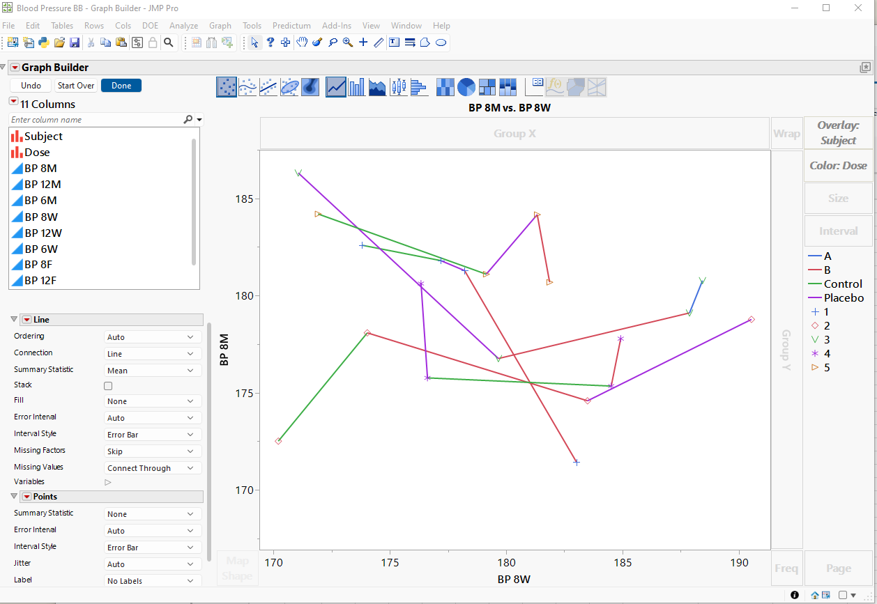

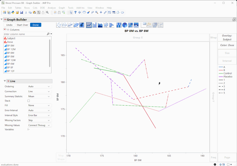

When I create a graph in graph builder with continuous data in the Y and the X axis, and use one categorical in the Overlay, I get continuous lines. But as soon as I put a second categorical in "Color," the lines change to dotted, etc even though the line style shows an uninterrupted line. This didn't use to happen and I don't know why it is happening. I had asked about this problem before and, unfortunately, the solutions didn't let work for my purpose.

Hi @babn, if you right click on the Overlay section, then choose Overlay Encoding > Color, I think this will get you what you're looking for. This behavior was changed to allow for more ways to create advanced graphs. @scwise did a great little overview of this here at timestamp 18:30 - 22:00.

Hi Jed, the only problem with this solution is that it eliminates individual markers. With colors in the encoding, I get only dots. I can change them individually but that's seems quite cumbersome for larger data sets.

Thank you for the effort. Unfortunately, it doesn't solve my problem with the interrupted lines.

... leading to this "workaround" via preferences/Graph Builder settings :
// execute the code if you know what you are doing - changing the preferences is dangerous
Set Platform Preferences(
		Graph Builder(
			Overlay Auto Line Styles Limit( 1, <<On ),
			Overlay Auto Marker Styles Limit( 62, <<Off ));
); //-------------------------------------------------- Open( "$SAMPLE_DATA/Blood Pressure.jmp" ); Graph Builder( Size( 843, 698 ), Graph Spacing( 4 ), Variables( X( :BP 8W ), Y( :BP 8M ), Overlay( :Subject ), Color( :Dose ) ), Elements( Line( X, Y, Legend( 11 ) ), Points( X, Y, Legend( 12 ) ) ) );
The idea:
  • Reduce the auto limit for line styles to 1 - to plot all lines as solid lines.
  • However, keep the auto limit for markers -  to get different markers for different overlay groups.
  • use color to specify the color.
The result:
  • individual traces for each subject
  • all lines are solid
  • different markers for the different subjects
  • color indicates: dose
    -> all the requirements combined into one plot.
