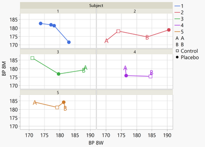

hogi
Level XIII
Re: Graph Builder Problem with Lines
Users will probably find a way to create the plot they want using tricks and workarounds.
However, the need for workarounds highlights the current limitations of Graph Builder.
Overlay is used for different/distinct purposes:
  • 1) to "group data" for smoother, line, bar and other plots
  • 2a) to control the style of lines
  • 2b) to control the style of markers
  • 2c) ...
This is great if you need one of these options or multiple options 'synchronously'.
However, it is inconvenient when you need multiple options in a non-synchronous way.
For example, at the moment it is not possible to assign markers for categories which don't coincide with the Overlay groups.
Let's try to create a plot with the following settings [just a slight difference to the plot in the previous post]:
  • individual traces for each subject
  • different markers colors for the different subjects
  • color marker indicates: dose
The graph looks simple enough, doesn't it? But it's extremely difficult to create it in Graph Builder.
Give it a try and share your experience!
Start with this script — all you need to do is adjust the markers.
