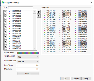

Have you tried manually changing the Legend Settings:
I used Semiconductor Capability dataset and changed NPN1 to character data type and used it in the Overlay part. This is the script after increasing the Max Items and wrap:

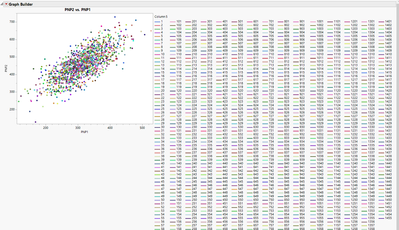

And the not so great plot:
And with more clear grouping (Column 5 is just row number):

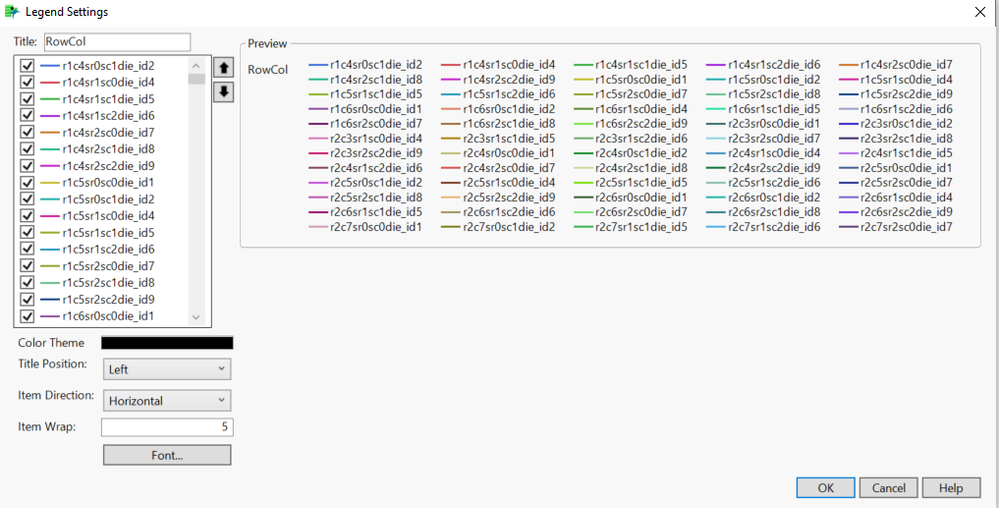

I don't have the option of the Max Items on the Legend Settings. I searched the Preferences and can't seem to find that option.
Do you know possibly where it is?

jthi
Re: Graph Builder Overlay Legend Limit
I seem to have the option in Legend Settings directly from red triangle menu of Graph Builder. I'm using JMP 16.2.0 Pro on Windows 10. Maybe it is a new feature? It isn't an option here either Legend Settings Window (jmp.com)

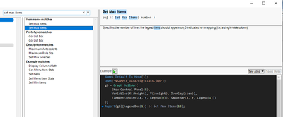

I couldn't find from documentation / release notes when that has been added. Did you try this script:
Names Default To Here(1);
dt = Open("$SAMPLE_DATA/Semiconductor Capability.jmp");
dt:NPN1 << Data Type(Character) << Set Modeling Type("Nominal") << Delete Property("Spec Limits");
gb = dt << Graph Builder(
	Size(65, 466),
	Show Control Panel(0),
	Variables(X(:PNP2), Y(:PNP1), Overlay(:NPN1)),
	Elements(Points(X, Y, Legend(21)), Smoother(X, Y, Legend(22))),
	SendToReport(Dispatch({}, "400", LegendBox, {Set Wrap(100), Set Max Items(1500)}))
and did you check from Scripting Index if you can find same Set Max Items as I can?
-Jarmo

ok thanks. Yes, I tried you script and the scripting index, but for some reason I don't have access to the setting the max items in the legend. I have sent a support ticket out to JMP, so hopefully soon I get an answer. I will make sure to update this post.
