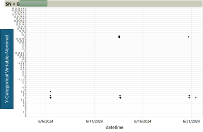

I have a data table that has a datetime column modelled as numeric-continuous.  I have various Serial Numbers ("SN", Categorical-Nominal) in another column, along with another Categorical-Nominal column, we can call "Y".  I want to see when certain "Y" events occur, so I put the Categorical Nominal Variable on the Y-axis and datetime on the X-axis.  For the purposes of this analysis, I choose to split each SN by Page.  When I do this, all Pages show all levels of "Y" on the Y-axis.  I only want to show the levels applicable to each SN on each Page.  Is there a way to exclude levels on specific Pages that don't exist for that group?

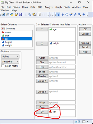

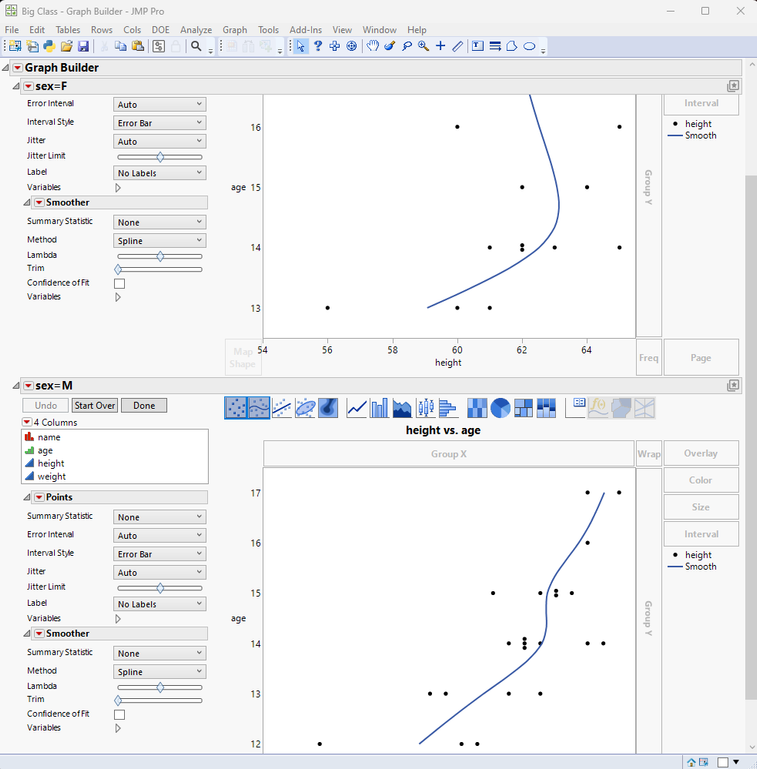

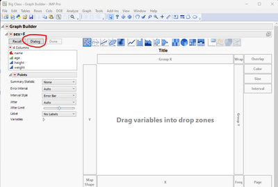

If you run Graph Builder and use the Dialog to enter the specifications for the graph
and then use the By selection instead of the Page
It will treat each level of the By grouping as an independent graph.   In my example, I deleted all rows for 12 year old females from the data table
Jim
