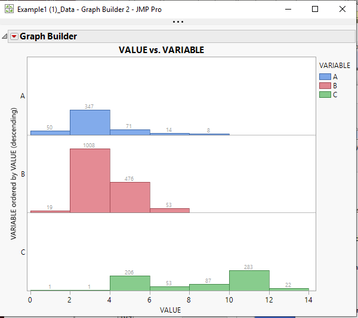

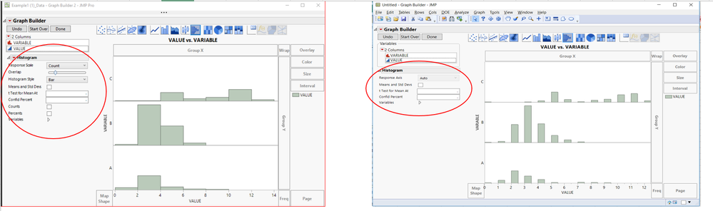

Dear Community,
some time ago... I created a "simple" but very interesting (for me) graph with Graph Builder.
After some weeks... I do not rememebr the steps I followed to create it.
Some of you is able to help be see step by step the generation of this graph (see the details on the left Y axis, the different colors, split by variables, legenda,...)?
In attachment you can find the data and the output I would like to have.
Thanks in advance for your help and feedback.
Best Regards,
Simone

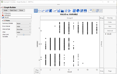

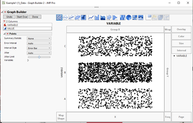

Simone1
Level IV
Re: Graph Builder - Help
Dear Statman,
thanks for the replay.
I followed you suggestions... but the risult is not as expectation.
I do not konw if I followed your suggestion in the correct way.
In attachment the steps and the output.
Some suggestion from your side?
Thanks in advance.
Best Regards,
Simone

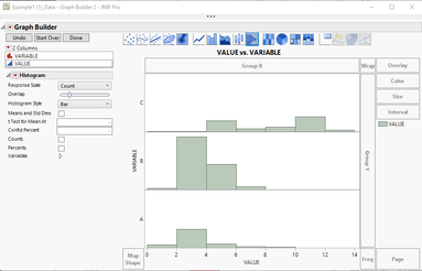

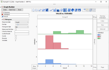

txnelson
Here are the instructions that I used to get what you want
1. Drag column Variable to the Y drop area.....not the Y Group Drop area
2. Drag the Value column to the X drop area
3. Click on the Histogram Icon
4. Drag the Variable column to the Overlay drop area
5. Click on the Counts Checkbox to label the bars
6. Right click on the Y axis and select Order By==>VALUE, descending to change the order of the Y axis
7. Click on the Done button
I believe this meets your desired output

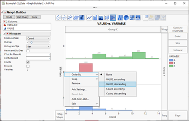

Simone1
Level IV
Dear Jim,
first of all thanks for your detailed feedback (appreciated).
But... Simone1_0-1584744458726.png... I have still 2 question
QUESTION 1
I followed your steps... but in one step the output is different (see below).
Do you know why?
Could it depends from the JMP version (I have JMP 14.0)?
QUESTION 2
I see your final graph... it is not "real" equal to the graph I created some weeks ago.
The main difference is in the Y axis (see below).
Do you have some comments on this?
This situation "making me crazy"... some weeks ago I created this graph with same JMP version and data...
and now... I'm not able to do it again...
Thanks in advance for your feedback.
Best regards,
Simone
