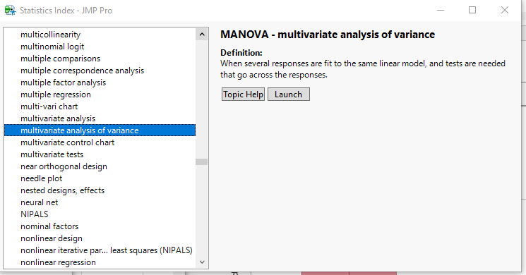

Go to
     Help==>Statistics Index
Click on the list of statistics, and then start typing Multivariate or MANOVA, and the list of statistics will move down to where you will see multivariate analysis of variance
This will give you the start you need.
