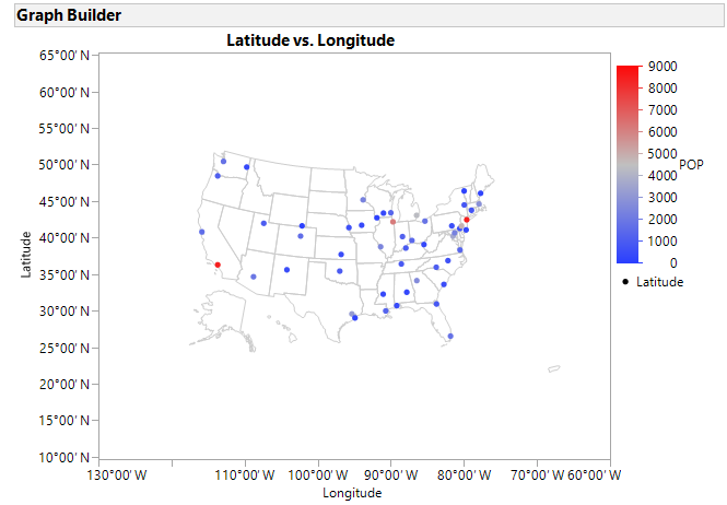

The default view for continuous X and Y data in Graph Builder will be the Points element:
This will result in a graph something like:

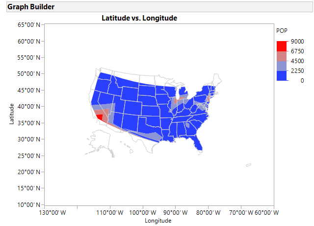

Changing to the Contour element will result in a graph like this:
In this case, I customized the graph further (Right click in frame > Customize) to:
  1. Clip the contours by the map shapes (JMP 14)
  2. Change the ordering to layer the contours under the map shapes
The Contour element will fill areas that are within the convex hull of the points using interpolation.
