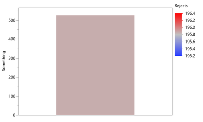

Is there a way to "turn" a Graph Builder colored by a continuous variable legend horizontal?
If I use this picture as an example,

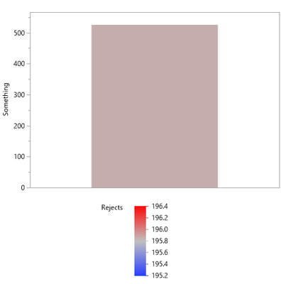

what I really want is to place the legend on the bottom and have the color bar go horizontal.  If I place the legend on the "bottom", I get this
and it is really unacceptable.  Is there a way to turn the color bar sideways (horizontal)?

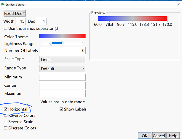

There is a checkbox in gradient settings to turn the legend horizontal. Right click on the legend and then go to gradient. Check the horizontal option.

Re: Graph Builder Continuous Color Legend Horizontal
.. and there is the answer!
Thank you! @O_Lippincott
