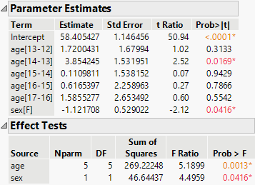

The effect coding used in JMP results in the sum of the effects of all the levels equal to zero, if I understand your question. You can get the overall test for the ordinal term below the parameter estimates.

Thanks, is there a coefficient (beta) associated with the overall term "Hispanic health literacy"? When I run the stats in SPSS it gives me a single beta coefficient for Hispanic health literacy (instead of for its 5 levels, which I can see in .jmp under expanded estimates).
Any advice on how to get that single beta for the overall main effect? Like here in the screenshot, can I get a single beta instead of one associated with each of the levels of the variable)?

What parameterization does SPSS use for your model? Here is what JMP is doing (nominal factors and ordinal factors), so it doesn't make sense (to me) to have a single coefficient. I looked for examples of SPSS output for models with categorical factors. None of them show a single parameter for such predictors.

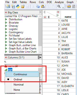

Re: Getting the coefficient for main effects in an ordinal variable - least-sq regression
I wonder if SPSS is treating the ordinal variable as a continuous one? If so, you can get the same behavior from JMP by right-clicking on the health literacy variable under the Columns' panel of the data table and selecting "Continuous." Then, repeat the step to fit your least squares regression. You should make sure that you want to make the assumption that the data are continuous rather than treating them as ordinal.

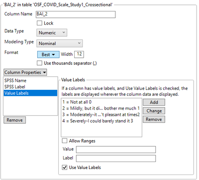

The factor levels in the picture of his analysis are not numeric, so they cannot be treated as continuous. They would have to first be recoded to a number (data type is numeric) before making it a continuous factor (model type is continuous).
Importing data from SPSS often leads to value labels being created, such as:
If this is the case, just changing to "Continuous" will be enough--but if there aren't any value labels, then recoding first to a number will be needed.
