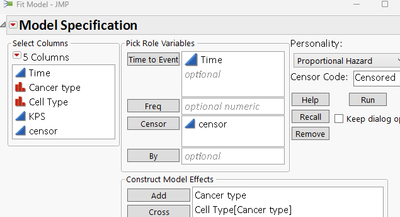

My second question, and this is something we have in the studies we run, would be regarding different treatment regiments (for instance Drug A gets dose schedule 1 and 2, Drug B gets the schedules 3, 4 and 5). We want to compare the drugs and the treatments. Let's treat them as categories, even though we might be comparing the dosings within a drug and would then treat the dose as a continuous variable, nested within the drug (any concerns here?).
To illustrate I separated the :Cell Type into :Cancer type just to get some level of categorical nesting. Would it be valid to run the model this way?

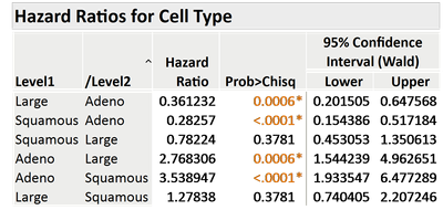

If the answer is yes - we still want to know what the differences between the sublevels are, because the numerical HRs we get for the categories do not make much sense, if we have two drugs with different schedules. Sure, those were selected based on, let's call it, "best practice", but that's completely arbitrary data.

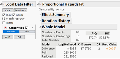

Can we, in the next step, run a PH model with a local filter, only selecting the non-small cell lung cancer?
so that we get HR values, that are actually of interest (or the "per unit change in regressor" for continuos data):
Nesting B within A means that you want to estimate the effects of B separately within each level of A, but you do not estimate the main effects for B.   (Another situation where nesting is used is when the levels of the nested factor have the same labels across groups, but their meaning changes depending on the group. See this JMP example Nested subject example.)

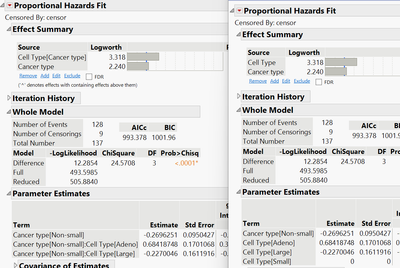

However, for your data on this example, nesting is not necessary since small cell type cases are the same as small cancer type cases, and squamous, Adena and large cell types are non-small cancer type. You will get the same results from the model with both Cell Type and Cancer Type, as shown in the screenshot below:
Yes, you can; however, this is in general different from running a single model on the combined sample. A typical model would include Cancer Type and Cancer Type as main effects and an interaction term. However, due to singularity in your data , this model cannot estimated.
