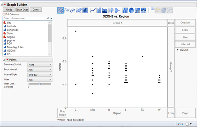

Hi,
I am working on the Cities dataset to build a journal of GraphBuilder objects. I have excluded a few rows, and it is clearly visible at the bottom of the graph (as shown in the image below) as "where 4 rows excluded". This has been built interactively, and I can remove the footnote manually. But since I am using a script, I want to incorporate a line in my code that does not show this footnote. Is there a way possible to achieve this?
Thank you.

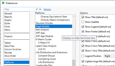

If you don't need the Footer at all, you can also disable it in the Preferences :
