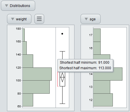

This isn't really an answer, but maybe useful in some cases. If you just wanted to see the shortest half values, you could save as Interactive HTML and hover over the red bracket.
Interactive HTML Box Plot Shortest Half ValuesInteractive HTML Box Plot Shortest Half Values
When viewing in a mobile browser, just tap the red bracket.
