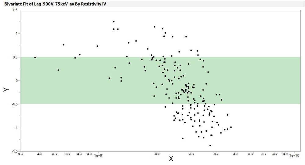

Hi,
My problem is probably very simple but I just don't seem to be able to figure it out.
I have a column Y that I have plotted it vs column X and it looks something like the attached image.
I want to find the range in X where it yields (or includes) 60% of Y points. There is no defind formula that relates the 2 columns.
Any ideas?

ron_horne
Super User (Alumni)
Re: Finding the X range that will include a certain portion of the Y
Hi @NSadeghi
please have a look at this script and let us know if it is useful.
perhaps someone else has a more elegant way of doing this. i would also like to know
You find, select, and subset the rows containing the (middle) 60% of the Y values, and then examine the distribution of the associated X values.

dale_lehman
Level VII
You could try including histogram borders and highlighting the section of the Y distribution - the X values should be highlighted.  Then, if you want to examine these, you can name that selection in a column of the data set (e.g., points of interest) for further analysis.
