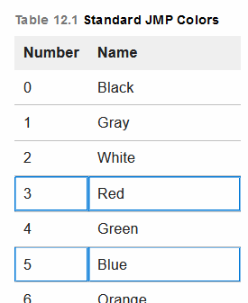

There is also << Get Primary Interval Line Properties (which doesn't really have any documentation)
Names Default To Here(1);
platoneway = Oneway(
	Y(:weight),
	X(:age),
	Each Pair(1),
	All Pairs(1),
	Comparison Circles(0),
	Means and Std Dev(1),
	Box Plots(1),
	Mean Diamonds(1),
	Mean Error Bars(1),
	Std Dev Lines(1),
	Grand Mean(0),
	SendToReport(
		Dispatch({"Means and Std Deviations"}, "Std Dev Lower 95%", NumberColBox,
			{Visibility("Visible")}
		Dispatch({"Means and Std Deviations"}, "Std Dev Upper 95%", NumberColBox,
		Dispatch({"Means and Std Deviations"}, "~Std Dev", PlotColBox, {Visibility("Visible")}),
		Dispatch({}, "Means Comparisons", OutlineBox, {Close(1)})
reponeway = platoneway << Report();
pcb = reponeway["Means and Std Deviations"][Plot Col Box(1)];
pcb << Get primary interval line properties;
You can try to extract the colors from that if really necessary
{3, 5, 3, 1, 1, 0, 5}
To understand what these mean, check Set primary interval line properties from scripting index
Syntax: obj << Set primary interval line properties( {color if upper < reference line, color if crosses reference line, color if lower > reference line, alpha, line width, pen style, cap length } )
You can find standard colors of JMP for example from here https://www.jmp.com/support/help/en/18.1/index.shtml#page/jmp/specify-colors-in-jmp-graphs.shtml
-Jarmo
