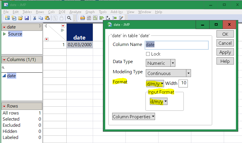

The resulting table looks like
Also showing the column info dialog.Also showing the column info dialog.

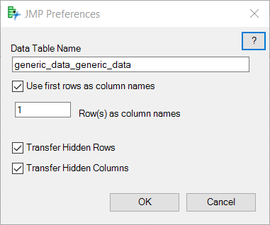

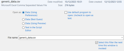

I am using Windows 10, and the files were indeed CSV. I have attached a small example file as requested (in CSV and XLSX). I have tried with both formats and the result is the same. Screenshot below is an example using the excel plugin to create a data table from the XLSX file, and the resultant datetime field using the incorrect format.
I have now tried importing the file by opening in JMP and selecting to use the set preferences, and that works in setting the correct format.
If I create a new empty table and copy/paste the table from the open CSV file, then that also works by using the import preferences.
So I think the problem may be in the Excel plugin itself? There are very few options in the Excel plugin unfortunately:
Thanks for taking the time to look at this. I suspect that I will just have to avoid using the plugin until this is resolved.

Hi All, this date format issue is an ongoing nuisance. I'm on JMP v18 and it's certainly still not resolved. The worst is, that you can't even force the d/m/y format upon JMP.
Check out the attached screenshots: import from csv, date format was dd/mm/yyyy.
When I go to column info and set input format to d/m/y (red square), it changes 4/11 (4th Nov) to 11Apr. If I set input format to m//d/y (yellow square), it ALSO!!! changes to 11Apr.
JMP cannot accept d/m/y, it seems, unless the day/date is beyond the 12th. Then even JMP backs down sullenly.

Once the data is in the data table as a date-time value (a numeric value in seconds since 1904), it can't be fixed/changed by changing the numeric input format on the data table. Future values hand-entered into the table will respect the current input format.
The table's output (display) format can be changed at any time; that does not change the internal representation, just the way the values are shown.
The right way:
The input format, specified in the CSV import, must be correct when the CSV file is read and converted to a datatable. It can't be fixed later; the 4/11 vs 11/4 error is already in the numeric seconds since 1904 value.
Craige

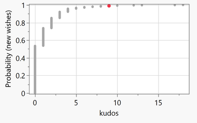

Please (!!) support this wish:
CSV import force MDY or DMY date format
 One of the most kudoed "new" wishes.
@Sarah-Sylvestre . is the status information up to date?
