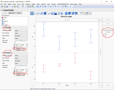

Hello, I would like to improve the first graphic below (see data table enclosed first script attached).
I am in JMP17.2.0, using graph builder to display two Y variables (A & B) in function of X (Labo), with an interval for each value of Y by level of X (U de A & U de B).
I would like to have the two Y variables in the same axis, and not one below the other.
But when I drag and drop to have the same axis (second print screen), I can't put a different column for each interval: it takes only U de B as interval role.
Can you help me please ?
Graphic ok with A below B on Y axis:

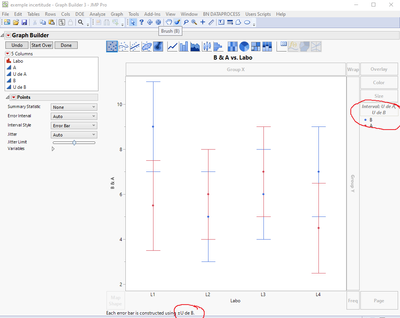

Graphic NOT ok with A & B on same Y axis: same column for Interval
Graph Builder(
	Size( 660, 666 ),
	Variables(
		X( :Labo ),
		Y( :B ),
		Y( :A, Position( 1 ) ),
		Interval( :U de A ),
		Interval( :U de B )
	Elements( Points( X, Y( 1 ), Y( 2 ), Interval( 2 ), Legend( 70 ) ) )

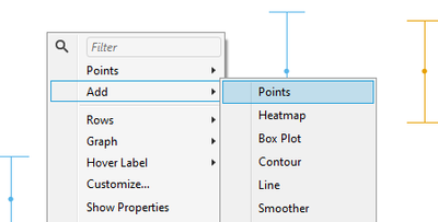

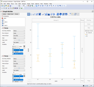

You can do the same thing you did with separate Y-axis by adding two point plots
It is still saying it is just using one column for intervals, but I'm quite sure it is using both

Many many thanks !

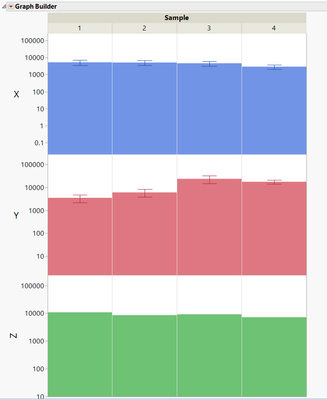

I seem to be having issues adding a third interval column to my data using Graph Builder to use and error interval on bar graphs. That is, I can only add two error intervals in Graph Builder at time, using the Interval drop zone (Adding the user-defined error interval option to the graph builder - JMP User Community), but it is not allowing me to add a third error interval for my third set of bars (green bars below):
What is the work around here? Thanks,
Jimmy

How does your data look like (you might have to do some data modifications)?
