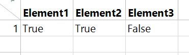

2) open the file directly into a table...open(file), below, produces this, probably using the huge guess. Needs an XML extension.
dt=open(file);
elementselements

Thanks for the quick response.  Using the XML wizard I was able to get it working.
