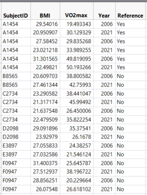

I am looking for a script that will automatically generate a summary/pivoted table of means and p-values for pairwise t-tests compared with one reference group. I am using JMP 17.
In the below data table, there are columns for SubjectId, measured BMI, measured VO2max, year, and Reference to indicate whether or not the row has a SubjectID that is a reference.
I have been generating summary tables manually (like the below) with means and then manually populating p-values for the one-sided t-tests.
I am interested specifically in the one-sided p-value results of a t-test between each SubjectID against the reference for each year to determine whether or not the non-reference SubjectID has a higher BMI or VO2max than the reference SubjectID. So far, I have been manually performing a pooled t-test and reporting the p-value and mean in a summary table I have created. Is there a way to iterate over a list of unique SubjectIDs and generate a summary table with these statistics performed in the way described using JSL? Additionally, a generalized way to add summary statistics (e.g. N for each SubjectID for each analysis) would be helpful.

Hi @txnelson and @SDF1 , I can hopefully clarify the request and maybe focus the scope a bit. I work with @LinkageBee996 so he asked me to help clarify.
The current workflow is as follows:
1) Start with the data table that @LinkageBee996 shared. To simplify things I'm going to ignore the year column and focus only on BMI.
2) Perform a simple two-sample t-test comparing each of the Subject ID's that are labelled as 'No' for reference to the Subject ID (A1454) that is labelled as 'Yes' for reference for a total of 5 comparisons (there's a reason we're doing this vs. doing something like a dunnetts test). We currently do this one-by-one by using the local data filter in the oneway platform under 'Fit Y by X'

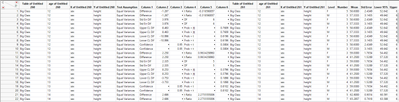

  I agree with @txnelson , it's difficult to understand how you're getting from your main data table to the one that you're generating manually. It might work better for your purpose to re-arrange your data table and organize it differently. This might require splitting it, or joining the data differently from how it's currently structured.
  The reason I mention this is that sometimes analyses can be done using a BY group variable, and then the analysis results can be easily obtained in a larger data table by right clicking a report table and selecting Make Combined Data Table. You can see if this is maybe what would work for you by using the Big Class.jmp sample data and doing an ANOVA Fit Y by X with :sex as the x-axis and :height as the Y (to see better how the make combined data table works, use :age as the BY variable). Perform your t-test, and then right click on the statistic table of interest and select make combined data table.
  If you do that for the t-test and also the Means for Oneway Anova, you can then join those data tables so that you have the mean value of each group along with the p-value for the t-test. It should end up looking something like this, which might be along the lines of what you're after.
