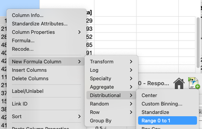

2. Range the stacked data column 0-1.
3. Super important to do this -> edit the range formula like this:
(:Data - Col Minimum( :Data, :Label )) / (Col Maximum( :Data, :Label ) - Col Minimum( :Data, :Label ))
This normalizes the data by the attribute that was stacked.  If you don't do this the analysis is mud.

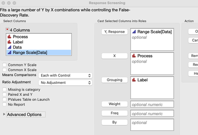

4. Analyze>Response Screening.  Set the dialog up like this:   (note Process in my example has two levels, comparing the old process to the new process.

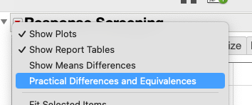

5. Use this option from the red triangle menu 

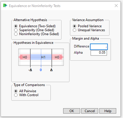

6. From here there are two options. The first option is a little complex and maybe cryptic as to what it will actually do, and the second is frustratingly limited. It would be useful to specify a value for each level, but that is why since we've already scaled the data to 0-1, chose the actual difference and pick some fraction of 0-1. For example if Process=Old vs Process=New for each scaled attribute is within 5% then they are practically the same, pick 0.05 of the difference to detect.
Now you have some results, except they are all in scaled units so I'm not sure how they would be practically intercepted.
