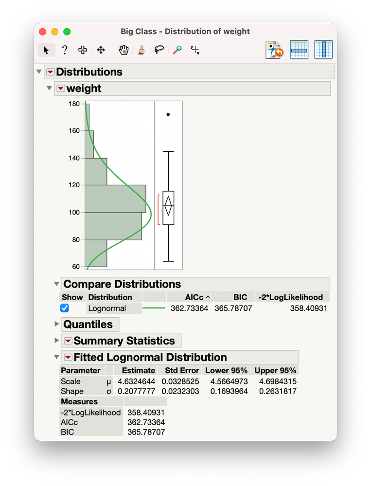

@ih has some good suggestions. The bootstrap estimate requires JMP Pro and you might have JMP instead.
The distribution model fitters in the Distribution platform provide confidence intervals. Here is an example using the sample Big Class data table and the variable weight. I launched the platform with weight, click the red triangle next to weight and selected Continuous Fit > Fit Lognormal because this distribution is skewed. (Another model might provide a better fit, but I am just illustrating the approach.) Notice that the table of estimates includes both the point estimate and interval estimate for the distribution model parameters.
Does this approach help?
