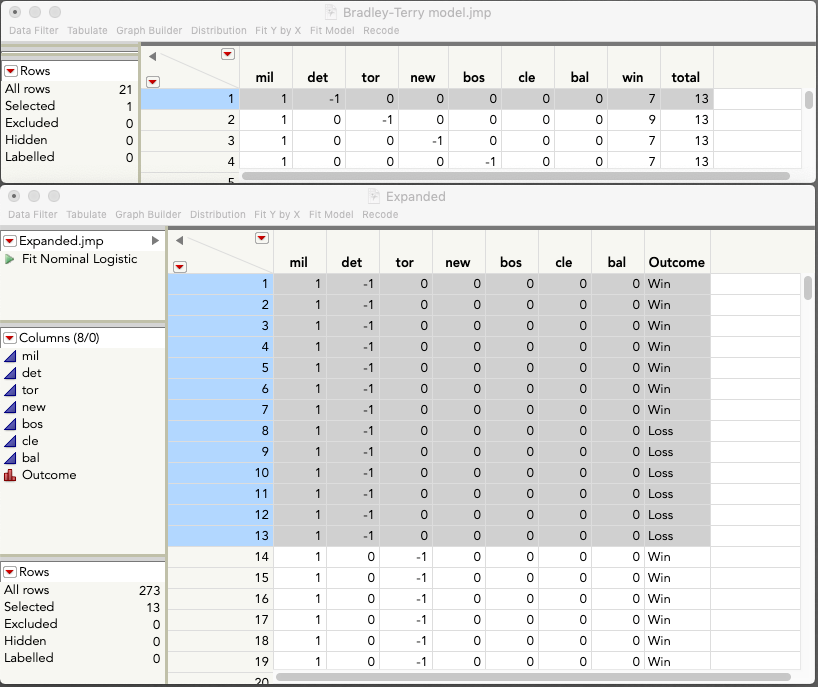

It is possible in standard JMP, but it requires a slight restructuring of your table. What you need is a nominal outcome variable of Win or Loss, and what you have is a summarized table of the frequencies of those occurrences. I've attached such an expanded table here, with the nominal logistic script saved (discussed below more). Note the form of these tables, in the image below is the original table with the first row selected, in the bottom is the expanded table, with the 13 rows selected that correspond to that one summarized row. Note there are 13, which are the 13 contests between Mil and Det, and there are 7 wins, and 6 losses, which reflect the win = 7 in the top table. expanded.png
The model is straightforward to set up: Analyze > Fit Model, with Outcome as Y, all the teams as model effects, and No Intercept checked. model.png
This returns the following output, which you will see matches:

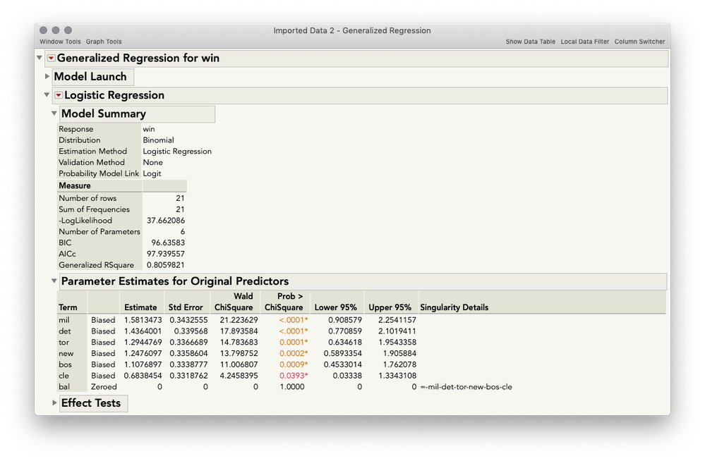

I better understand what you're trying to do now. To match those results (Bradley-Terry model) you will need to use the Generalized Regression platform, which is available in JMP Pro only. I've attached a JMP version of the data table used in that SAS example and saved the script to the table. Here are the steps to reproduce this:
1. Launch Analyze > Fit Model.
2. Specify Generalized Regression as the Personality, and Distribution as Binomial.
3. Enter both Win and Total as Y, Columns, and enter all predictors as model effects.
4. Check "No Intercept" at the bottom.
Your Fit Model dialog should now look like this:

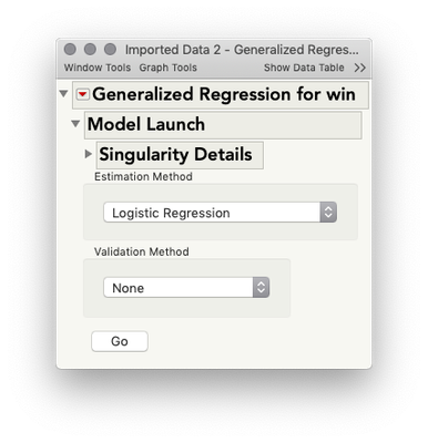

5. Click Run, then in the resulting dialog, specify Logistic Regression as the estimation method, and click go:genreg.png
This will return the following output, which you can confirm matches the SAS results.
results.pngHere is the JSL for this analysis, which is also saved to the attached table.
