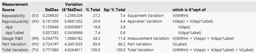

My selections
Right click on the table box under Gauge R&R and enable % Total (it might also be a good idea to show and compare variance components)
If there are something you aren't understanding, select "?" tool from toolbar and click on some part of the platform and it will open Help page for you  Quality and Process Methods > Variability Gauge Charts > Variability Gauge Analysis Report Options ...  and then go through the documentation to understand the report better. Most likely you are comparing values which aren't the same (% Total vs Sqr % Total).
-Jarmo

I have a typo above, 43.2% should have been 34.4%
If I had selected Bayesian analysis, then the % Gauge R&R matches.
Perhaps I am not understanding the JMP results...
34.3% Gauge R&R vs 11.79 % of Total?

Re: GRR result from JMP is not matching web example
My selections
