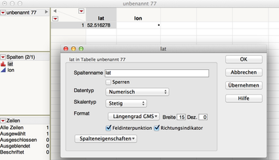

Thanks! The thing with the decimal vs. DMS format does definitely make sense. But the entering of decimal values as they are grabbed from the google maps and applying the geographical format on they is that i was doing first. It was not successful either. I have just tried it again. The value 13.377868 disappears after i push OK applying the new format to it. Here how it looks like:6875_lon_lat.png
ms
Super User (Alumni) ms
Super User (Alumni)
Re: GPS coordinates for Europe do NOT match?
It looks like JMP treats the "number" as a string. Change to comma instead of period as decimal mark before setting the  geographic format.

Thanks a lot!!!!! That was a point!!! This is probably because of German layout on my mac.
