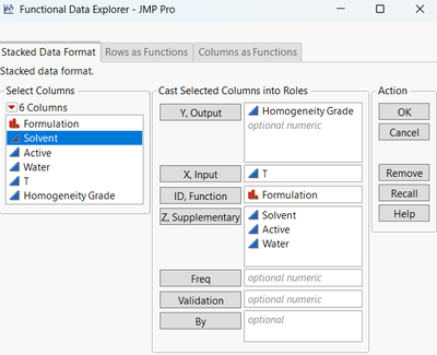

In order to launch an FDOE analysis, you have to enter your DOE factors as Z, Supplementary, and make sure that all factors have their column properties correctly configured :
For Mixture factors, you should have for each factors the following column properties and configuration :
  • Mixture : With Lower and Upper limits specified.
  • Design Role : Mixture
  • Factor Changes : Easy

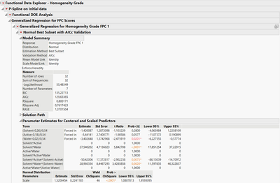

If the mixture factors are correctly configured and used in the Functional Data Explorer platform, you should be able to launch the FDOE analysis and have a correct mixture model (without intercept):
