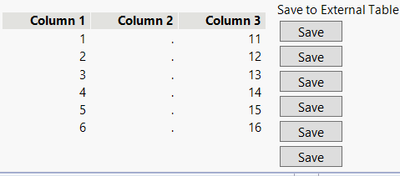

Note that when the attached script / function to the ButtonBox runs, it has no view of the scope for which it was created.  This differs from other programming languages (like Python) which maintain scope for when functions were created.
In JSL, use the Eval( Eval Expr( ... Expr( var ) ... ) ) construct to pre-evaluate certain parts of the code.  Here is an example.
Also, I'd use the ColBox() function to add the buttons as it will auto-align all cells:
OutputTable = Current Data Table();
HList = H List Box( OutputTable << Get as Report() );
	//Show(Column(OutputTable, 3)[1]);
SavingVlb = V List Box( Text Box( "Save to External Table" ) );
col box = Col Box( "" );
hlist[Table Box( 1 )] << Append( col box );
For( i = 1, i < N Rows( OutputTable ) + 1, i++,
	Eval( Eval Expr(
	BB = Button Box( "Save",
		<<setFunction(
			Print( Column( OutputTable, 3 )[Expr( i )] );
	col box << Add Element( bb )
Insert Into( HList, SavingVlb );
New Window( "test", HList );
