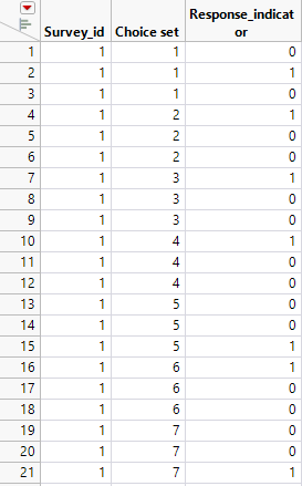

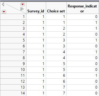

Dear community,
Just a quick question considering the formatting of the "No choice" option in JMP 17.
If we have Option A, Option B, and Option C, where Option C = none of these options. Do we give three rows of data to JMP? Or would we give two rows of data in binary format, and when both option A = 0 and Option B =0, it will use this information that no option was selected?
In the images below see in particular choice set 5 and choice set 7, where the respondent has selected the "No Choice" option. So, which of these coding formats is correct?
