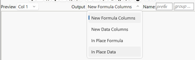

It is soo useful,
 the new *)  hogi_4-1734071286547.png command in the New Formula Column submenu:
*) one of the helpful, new features in JMP18.
Basic mode can save you hours over the course of a week:
No need to 1) create a column, 2) add a formula, and 3) search for the input column.
Simply: create a formula column with the input column already in place 1+2+3.
This is not all, the developer added some cool features to control 1 and 3:
1) do you really want to create a formula column?
maybe just calculate the value - maybe just overwrite the previous values , e.g. to convert Å to nm:

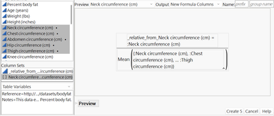

3) for the input column - just select multiple columns and you will get a new menu which can be used to synchronize the formulas:

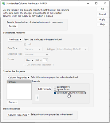

Part of it was already possible via Substitute Column Reference in the Standardize Columns menu:
The new way is MUCH more intuitive - and much more flexible.

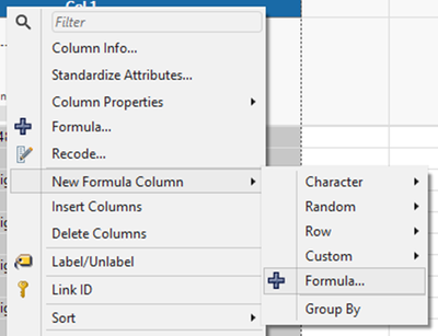

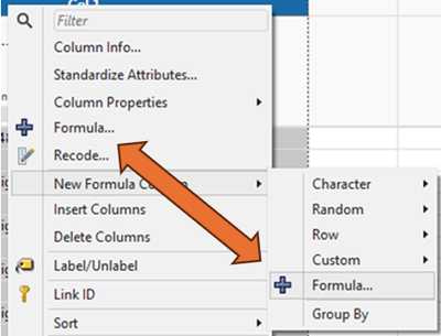

If there is one drawback, it's the similarity to the other hogi_1-1734071510838.png command in the main part of the column right click context menu:
The similarity of the entries makes it difficult for beginners to distinguish between both function.
From the positioning, it gets clear that both of them do completely different things:
    The one below Column Properties is intended to edit the formula of the current column(s)
    The one in the New Formula Column submenu is intended to add a new formula column, either by generating new column, or by adding them to the current column(s) .
NB: This distinction is not 100% correct.
When there is no  formula in the column and you click on hogi_2-1734073644137.png, it adds a formula column.
When you select multiple column, [with or without formulas] and you click on hogi_2-1734073644137.png and then on
the menu will open in hogi_3-1734073719701.png mode.
