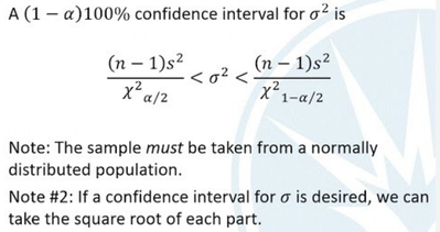

The formula for the standard deviation confidence interval is usually this:
I believe these are the formulas that JMP is using for the standard deviation confidence intervals that are available from the Distribution variable name > Confidence Intervals menu choice..
