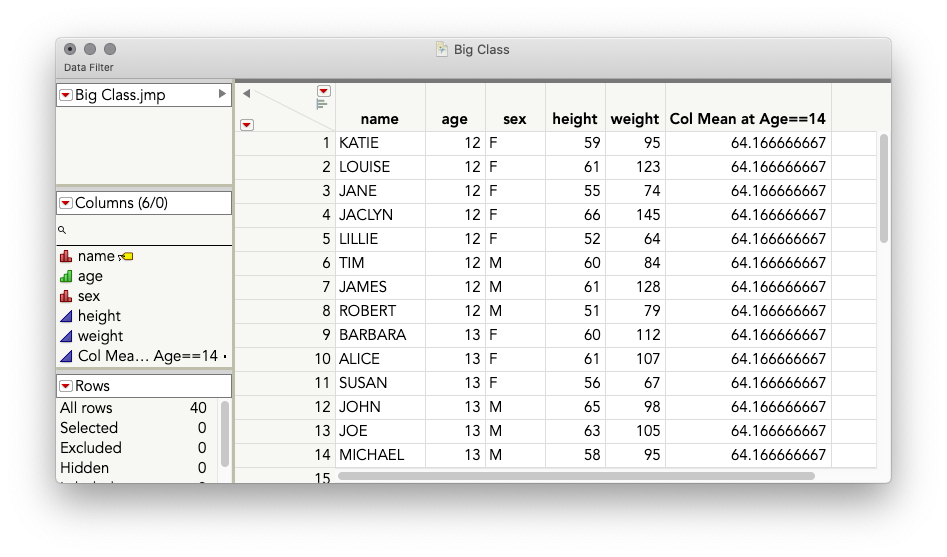

There's a straightforward way to do this using Col Mean() that's not obvious until you see it. Col Mean() take a Frequency column argument:
Usually, this is for when you need to weight using another column. But, in your example, what if we could weight the values of Age==14 as 1, and all other values as 0? That would give us a mean of just those individuals where Age==14. We can do that directly in the formula:
Col Mean( :height, <<Freq( :age == 14 ) )
This will return:
Now, for your specific question, centering with respect to this specific mean from height, we can wrap that into the formula in the usual way:
:height - (Col Mean( :height, <<Freq( :age == 14 ) ))
I hope this helps!

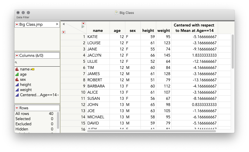

It does appear <<Freq was added as an optional argument in JMP 15, so for earlier versions of JMP you will need to do something else.
Here's a solution from jmp wizard @brady_brady:
:height - Mean( :height[(:height << get datatable) << get rows where( :age == 14 )] )

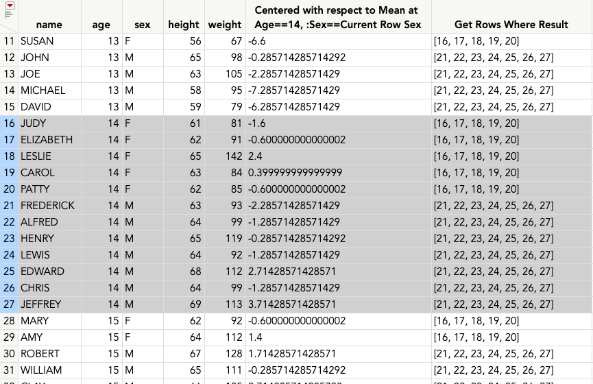

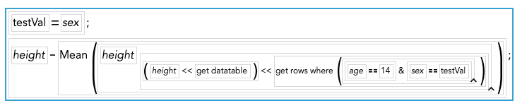

Yes, I can see how wrapping this in conditionals might not be ideal for many cases. Here's a modification to @brady_brady's solution that should work (table attached):
testVal = :sex;
:height - Mean( :height[(:height << get datatable) << get rows where( :age == 14 & :sex == testVal )] );
In this case, we grab the value of :sex for the current row, save it to a variable, testVal. Then, when we evaluate the centering function, we can test use that value in the get rows where() function.
Here is the table with a column of just the rows selected by this Get Rows Where() function:
As you can see, all rows use age 14 as the subset, but which sex subset is determined by the current row values of sex. Should be easily adapted to different levels of complexity.
