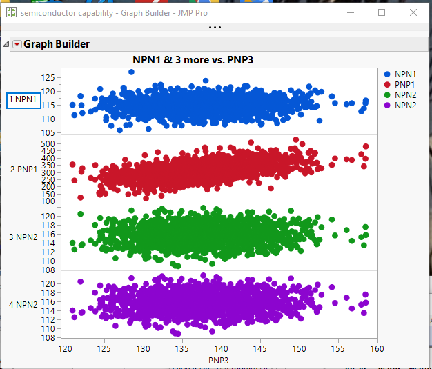

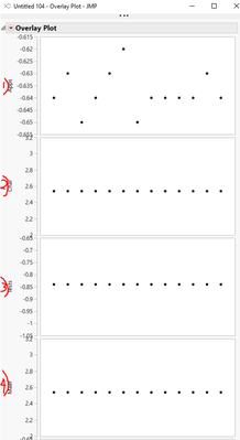

Hi All,
Is there a way I can number the overlay plots? I want something similar to the pic attached below
Thanks
txnelson
Re: Numbering the overlay plots
I am going to point you away from the Overlay Plot for a couple of reasons
  1. The Overlay Plot, and even more for the real old version of the Overlay Plot, that you are using has been depleted in value and will be going away sometime.
  2.  Because of the Tree Structure of the output from the old Overlay Plot, trying to get a value to the left of the label is tricky.
Therefore I am pointing you to the Graph Builder, to a plot that looks just like your included graph.  Here is how I am handling your repest:

(Report( gb ) << xpath( "//TextEditBox" )) << Rotate Text( "Horizontal" );
For( i = 1, i <= 4, i++,
	Report( gb )[Text Edit Box( i + 3 )] << set text(
		Char( i ) || " " || Char( Report( gb )[Text Edit Box( i + 3 )] << get text )

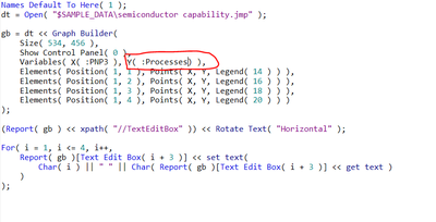

Hi @txnelson ,
Quick question: What's the syntax for selecting the whole column group (Processes) in Y axis?

You will have to list out all of the columns separately.  Here is the script that is generated by JMP when one has dragged the Processes group to the Y drop area, and the Site column to the X drop area.
