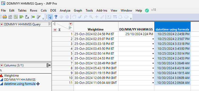

Look to create a column with DD/MM/YY HH:MM:SS

I believe this is what you want.......I arbitrarily set the GMT offset to -9 hours.....set it to whatever you need it to be
If(
	Contains( :Weightime, "ST" ),
		Informat( Substr( :Weightime, 1, Contains( :Weightime, "ST" ) - 2 ), "ddMONyyyy h:m:s" ),
	Contains( :Weightime, "GMT" ),
		Informat( Substr( :Weightime, 1, Contains( :Weightime, "GMT" ) - 2 ), "ddMONyyyy h:m:s" )
		-In Hours( 9 )
Jim

DELANDJ1985
Level III
Re: Formula to fix excel date format with IST and/or GMT
Thank you Jim - much appreciated.
