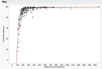

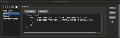

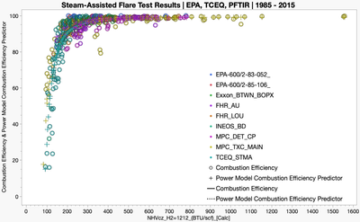

I performed a curve fit in JMP and saved the formula to a column (see below). I would like to be able to have the same curve appear in Graph Builder.
 I have tried to use Customize>Script to add the saved formula as a Y Function but nothing happens. See below.
I'm sure I'm making some kind of simple error but I'm stuck at this point.
Any suggestions?
Thanks in advance for any help.

Figured it out. I can add the formula to Custom>Script, but I have to change the column name to x.

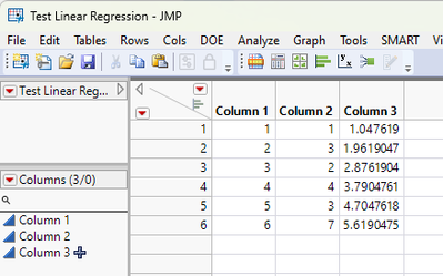

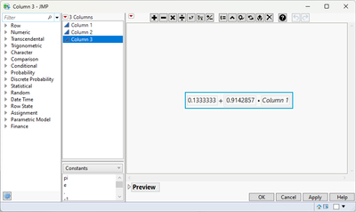

Add a formula column to your data table, using your function.  Then add that column to the graph as a function.  Here's an example with a simple linear regression
dt = New Table( "Test Linear Regression", Add Rows( 6 ),
	New Column( "Column 1", Numeric, "Continuous", Format( "Best", 12 ),
		Set Values( [1, 2, 3, 4, 5, 6] ) ),
	New Column( "Column 2", Numeric, "Continuous", Format( "Best", 12 ),
		Set Values( [1, 3, 2, 4, 3, 7] ) ),
	New Column( "Column 3", Numeric, "Continuous", Format( "Best", 12 ),
		Formula( 0.1333333 + 0.9142857 * :Column 1 ) )
gb = dt << Graph Builder(
	Size( 522, 456 ),
	Show Control Panel( 0 ),
	Variables( X( :Column 1 ), Y( :Column 2 ), Y( :Column 3, Position( 1 ) ) ),
	Elements(
		Formula( X, Y( 2 ), Legend( 12 ) ),
		Points( X, Y( 1 ), Legend( 13 ) )
	SendToReport(
		Dispatch( {}, "400", ScaleBox,
			{Legend Model( 12,
				Properties( 0, {Line Color( 19 )}, Item ID( "Column 3", 1 ) )
Here's the formula column:

scott1588
Level IV
Re: Formula plot in graph builder
Hi Mark,
Thanks for your reply.
As a matter of fact, I looked at that exact page before my post. I must not understand the process properly because it is not working for me. When I drag the formula to the Y axis with the individual values on the X axis Graph builder just plots individual data points for the function, not a smooth curve. See attached image. The Legend shows a line but there is no line.
I'm not sure what I'm doing wrong here.

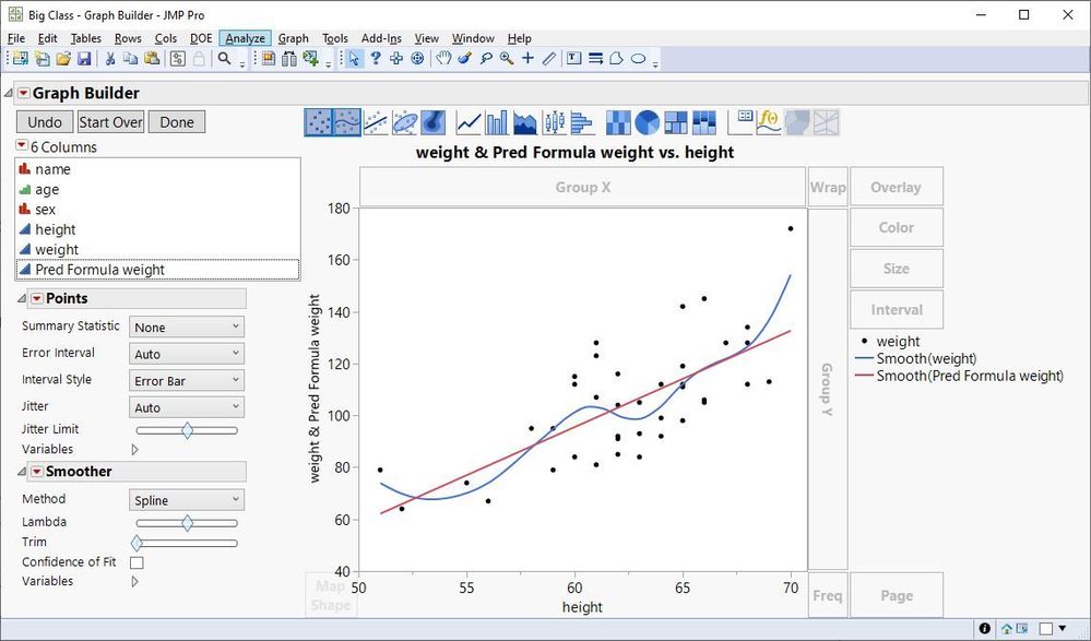

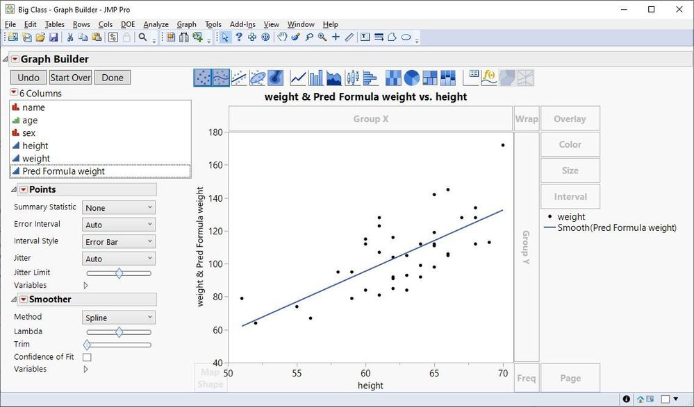

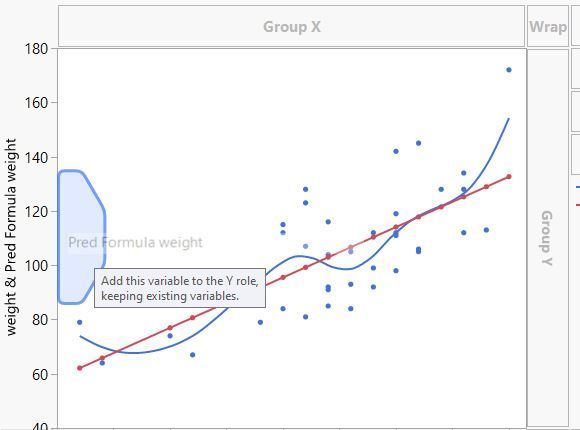

You seem to be plotting the data, not the formula. Try this: drag the predictor data column to the X role, drag the response data column to the Y role, and then drag the formula data column just to the right of the Y role (inside the frame and close to the left border). JMP should preview the result until you release the mouse button. You should see the formula added to the markers.
Here is a step-by-step solution.
  1. Drag the predictor data column to the X role.
  2. Drag the response data column to the Y role.
  3. Drag the formula data column to the right of the Y role inside the frame.
  4. Right-click in the frame and select Points > Y > (formula data column) to remove the markers for the formula.
  5. Right-click in the frame and select Smoother > Y > (response data column) to remove the markers for the data.
scott1588
Level IV
Well... I'm an idiot. It turns out that I have two similarly named predictor columns. I used one to generate the curve fit equation but I inadvertently used the other on the X axis for graph builder. Once I corrected this, the Formula Graphics element worked like a charm.
Aaargh.
Thanks for all your help. The incredible support from the JMP staff and community are a HUGE reason why we use JMP.
