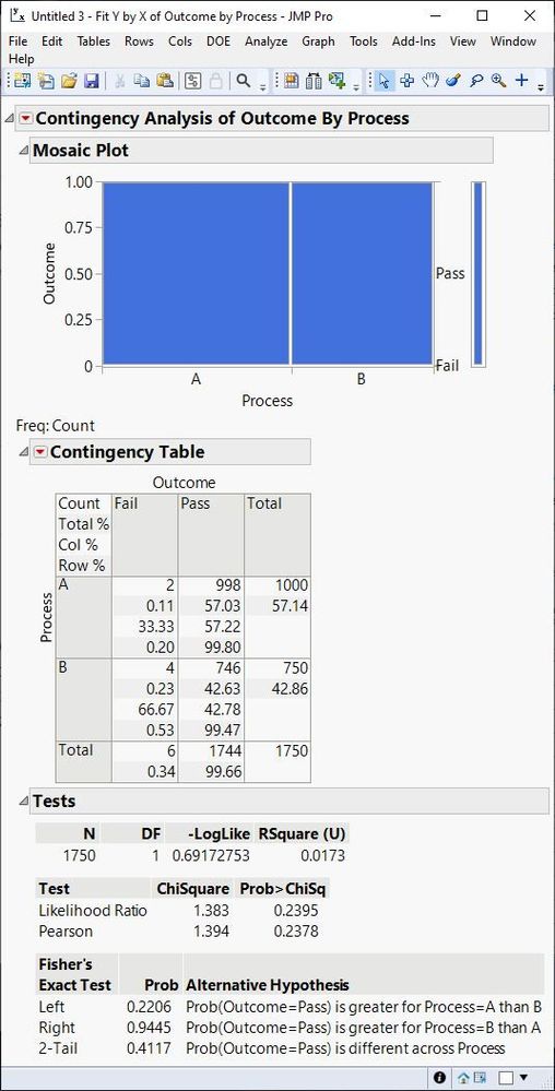

Process A has 2 fails out of 1000 units and Process B has 4 fails out of 750 units. Point estimates of failure rate are 2/1000 = 0.002 and 4/750 = 0.005 for Process A and B, respectively. How can I use JMP to prove statistical significance of failure rate difference? How do I setup the data table for that? How to put confidence interval around those failure rate estimates to check if intervals are overlapping or not?
Hi @cfs_analyst : See the attached to get you started. I've included two analyses. One comparing them, the other looking at each process individually Be careful, overlap (or not) of individual intervals does not define statistical significance; they have to overlap "enough" to be not statistically significant, so the comparison script (Fit Y by X...) is the right one to make the comparison. There you will see the 95% confidence interval on the difference. It includes zero, therefore no statistically significant difference at alpha = 0.05.

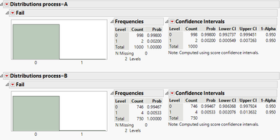

Thank you @Mark_Bailey & @MRB3855 for the statistical significance analysis method!
@MRB3855, for putting a confidence band around the failure rate (0.002 Vs 0.005), I can use the lower and upper CI of Level=1 in the distribution platform?
Hi @cfs_analyst . Yes, you’d use the lower and upper CL for Level =1; I used 1 as a failure and 0 as non- failure. I could have used Pass and Fail or some other desired descriptors as @Mark_Bailey did.
