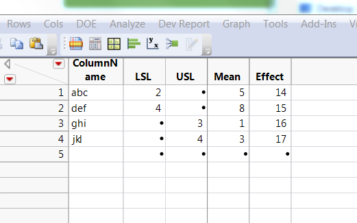

I have to manipulate data using various formulas and store the output in one final column. I am able to apply the formula successfully and store data in a new column but not in the same column.
For example,
In this table,
I am using Formula(abs(Divide(Effect,Subtract( USL,Mean)))*100)) for cells where USL values are present and
Formula(abs(Divide(Effect,Subtract( Mean,LSL)))*100)) where LSL values are present. But for cells where the column name, LSL, and USL are empty, I want to use the formula: Formula(Divide(abs(Effect)), Mean);

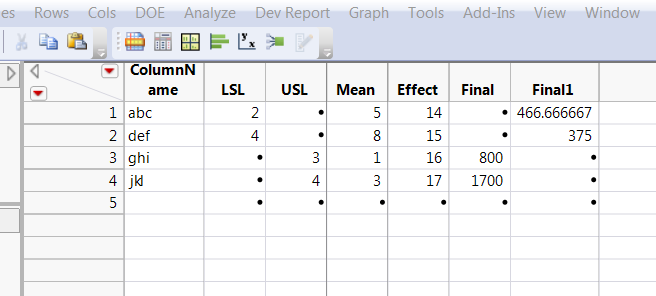

The output I get now is:
whereas I want the values of Final1 to be in the same column. Also,

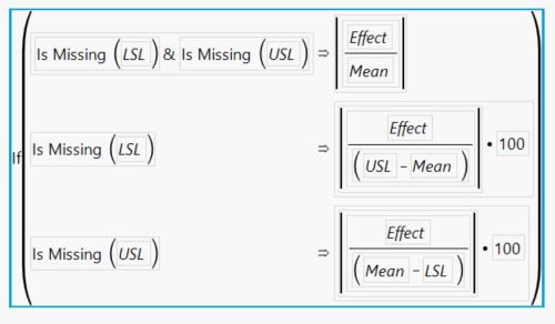

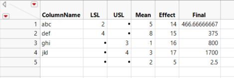

This seems a little overly complex to me. All of the calculations can be put into a single formula column:
If(
Is Missing( :LSL ) & Is Missing( :USL ), Abs( :Effect / :Mean ),
Is Missing( :LSL ), Abs( :Effect / (:USL - :Mean) ) * 100,
Is Missing( :USL ), Abs( :Effect / (:Mean - :LSL) ) * 100
It does not need to be scripted. Interactively it looks like this:
and it gives these results:
If(
