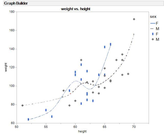

The easiest way that I found for JMP to handle this, is to modify the legend, and therefore the graph using JSL, to match your Row States.  Here is a script that shows how to modify the legend in Graph Builder.
Names Default To Here( 1 );
dt = Open( "$SAMPLE_DATA\big class.jmp" );
Graph Builder(
	Show Control Panel( 0 ),
	Variables( X( :height ), Y( :weight ), Overlay( :sex ) ),
	Elements( Points( X, Y, Legend( 1 ) ), Smoother( X, Y, Legend( 1 ) ) ),
	SendToReport(
		Dispatch(
			"400",
			ScaleBox,
			{Legend Model(
				1,
				Properties( 0, {Marker( "FilledTall" )} ),
				Properties( 1, {Line Color( 1 ), Line Style( "Dashed" ), Marker( "Filled Diamond" )} )
			), Legend Model(
				1,
		Dispatch( {}, "400", LegendBox, {Legend Position( {1, [2, 3], 1, [0, 1]} ), Position( {2, 3, 0, 1} )} )
It produces the following

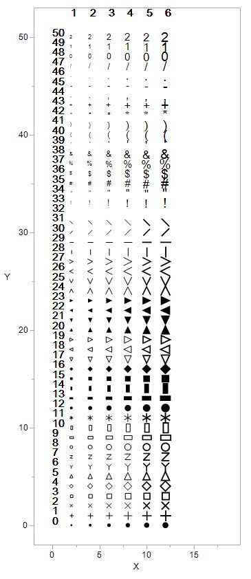

1. The markers are numbered as can be seen in the chart below.  This was generated by a script, as demonstrated int the scripting guide
     Help==>Books==>Scripting Guide
Some of the markers have names assigned to them, which you have seen in the Graph Builder script.  I don't know of any listing of those name, but you can always interactively run a Graph Builder and assign the marker you want, and then view the script it produced and see if it gives you a name and not just a number.

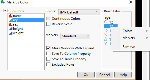

I haven't figured out how to do it with a script but if you go to Rows>Color or Mark By Column
you get the following
Now you can right click on the legend and change it to whatever you want, and if you have "Make Window with Legend" selected it will create a legend for you.  This has the added benefit of selecting in the table anything you've selected in the legend.
You can do the same inside scripting with:
Names Default to here(1);
dt = Open("$SAMPLE_DATA\Big CLass.jmp");
legend = dt << Marker By Column(:age);
new window("Not Really",
	Hlistbox(
		bivariate(Y(:height), X(:weight)),
		legend
But you lose (at least I haven't found a way to do it) the customizabilty that you're after
