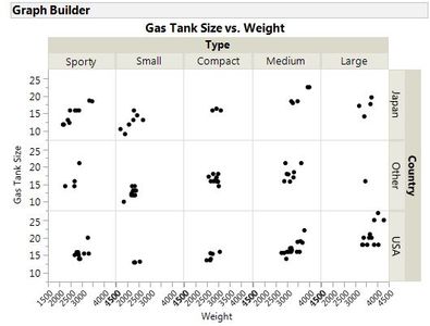

Perhaps this is a better example using cars physical data, what I was hoping for was a 3x5 matrix or a 15 item list.
Am I best recoding the character columns as Numeric in order to make the best use of summarise()? Is likely to be quicker/tidier than for loops?

If all of your grouping variables were numeric, it would be faster, because the summarize would be able to make quick work of the counting.  But that is very restrictive to the data and/or the user.  You could convert the summarize function calls to "Summary" platforms, and create tables which can handle both numeric and character columns.  You could do some timing tests to see if that will work.
