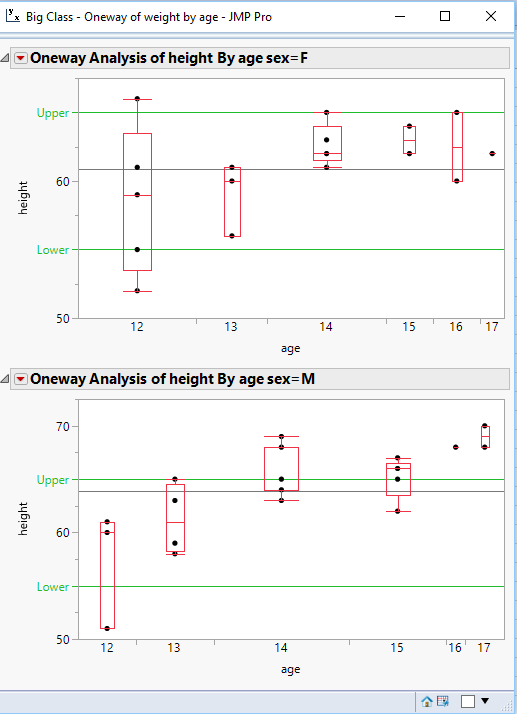

I suggest that you just enter the values from your second data table as a "Response Limits" column property.  If you do that, they will be displayed on the charts you are using automatically.
Jim

Here is a script that first creates the 2 data tables you displayed in your first entry, followed by the code that copies the limits from the limits table and applies them to each column in the main table
