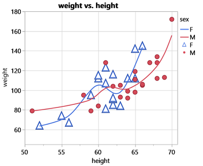

With the current limitations of Jmp - what is the easiest way to plot a specific class of data points with a defined marker?
I mean: automatically - without the need to specify the marker again and again via the plot legend.
I know that I can select all female entries and define "open triangle" via the row states.
But my actual data set is not static like Big Class. So, that's no option.
Hm, does anybody have a cool trick ?

You can select Rows > Color or Mark by Column... whenever the data changes to re-assign the markers as desired. Otherwise, you can write a utility script and add it to the Rows menu or make an Add-in to change the Marker row state after each data update.
For Each Row(
	Row State() = If( :sex == "F", Marker State( 5 ), Marker State( 1 ) );

And if all corresponding rows have the same marker state, the legend will adjust accordingly - brilliant!
