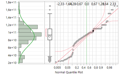

Dear all,
I am using JMP 15. When I aim to fit the Poisson or Negative binomial as the distribution and plot it on top of count data, I get the error:
'Exception in platform popup command'.
I have the Fitted Poisson Distribution parameters appearing, but here I can only add Normal curve, not the Poisson.
Does anybody know why?
Thank you.
