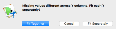

But my problem is that I need to use the Fit Model function, after cliking on a button.
If I insert the previous script in a Button Box it does not work properly and I do not understand why:
new window("test",bb=button box("Fit Model"));
bb<<set function(
    Fit Model(
    Y( :Y1, :Y2 ),
    Effects( :X ),
    Personality( "Standard Least Squares" ),
    Emphasis( "Effect Leverage" ),
    Run()
When I click on the button, JMP opens the window to ask the user if he want to fit separately or fit together, instead of directly fitting together.
Do you have an idea of how I could fix this ?

Yes, I see the effect too (JMP 12.1 on the Mac).
If you press the 'Together' button, JMP tries to be helpful and pops up this:
but, if you run the code behind the button directly it doesn't (which is the desired behaviour). No good idea how to stop this, unfortunately. Please mail support@jmp.com and reference this thread.

Just want to add that the pop-up is suppressed if Fit Model is explicitly told to fit separately.

Indeed it works easily and perfectly with "Fit Separately", thanks !
Unfortunately I have tried with "Fit Together" and the pop-up still appears. Is there another way to precise explicitly that we want to fit together?
