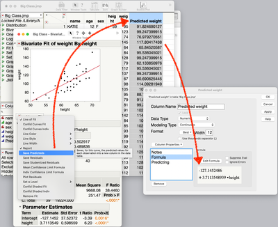

You can save the prediction formula of any data model you fit in a JMP report.  To do with Fit Y by X, you would first run the platform with your X and Y variables, then fit the model you want to fit (ex Fit Line), then under the graph you will see a red triangle next to the legend of the Fitted Models.  Click that triangle and choose "Save Predicteds".  That will create a formula column in your data table of that model.
Here is an example script of that:
obj = dt << Bivariate( Y( :Weight ), X( :Height ) );
obj << Fit Polynomial( 1, {Save Predicteds} );

The Save Predicteds command from the red triangle menu will save a Formula column to the data table.
If you're looking for optimization, don't overlook the Profiler. It is tailor-made for that and will work with the formula you save from Fit Y by X.
-Jeff
