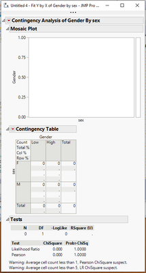

But when I use a different Y variable, also 2 levels (e.g., 'low', 'high'), character type, nominal, it does not work. I enter the variables into Fit Y by X and get a blank screen.

If you are getting a blank screen similar to the one below, it is because none of the rows in your data have values for both of the columns in your analysis.

This is the blank screen I'm getting:

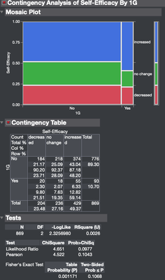

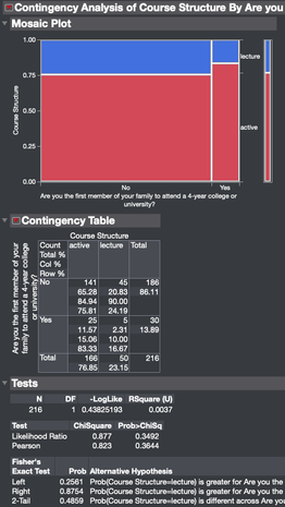

And here is an example of it working with a different Y character/nominal variable:

As part of de-identifying the data, I shortened the variable/column names. I test-ran it to reproduce the same blank screen, but didn't. Instead, it worked!
The one variable that worked previously was a short name. It would only work, though, if it was entered as a Y variable in Fit Y by X. But it would produce just a blank screen if entered as an X variable.
But now all my categorical/nominal variables - with shortened names - work as either the Y or X variable. Strange, no?
