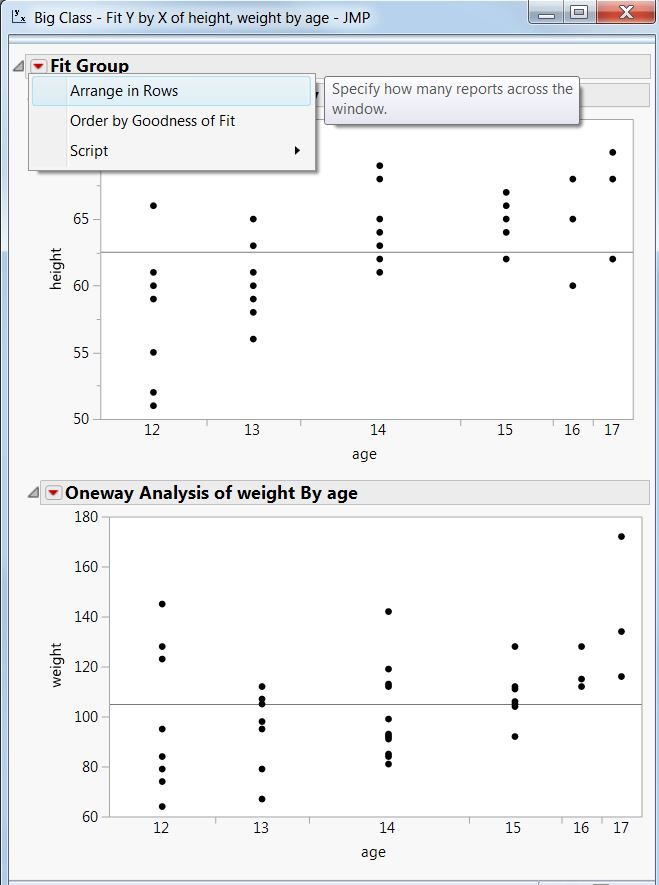

Re: Fit Y by X Graphs created in a row rather than column?
I am glad that the scripting option works for you, but regular JMP version 12 does still have the ability to arrange the graphs in rows. Perhaps this screen capture will show you where to click. The VERY TOP outline item will say Fit Group. That red pop-up will have the Arrange in Rows.
Although this screen capture was on Oneway and not Bivariate, it looks exactly the same for Bivariate.

txnelson
look under the red triangle, and select "Arange in Rows".

txnelson
After you have run your plots in Fit Y by X, you can go to the red triangle in the output, and select Rarange in Rows
Which will give you
What am I missing?
Jim

txnelson
I suspect you are correct.  Yes, I am running JMP Pro.  If running a script fits into your posibilities of a solution, here is a very simple script that will do what you want
Names Default To Here( 1 );
dt = Open( "$SAMPLE_DATA/semiconductor capability.jmp" );
ycolList = {"NPN1", "PNP1", "NPN2", "PNP2"};
New Window( "FIT By Y Outputs",
	H List Box(
		For( I = 1, i <= N Items( Ycollist ), i++,
			Oneway( Y( Column( dt,ycollist[i] ) ), X( :wafer ) )
Jim
