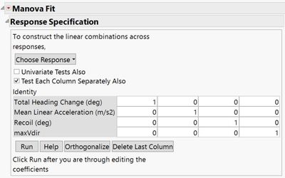

I am trying to jury-rig a post-hoc pairwise slope comparison with a custom test. I read through the documentation on custom tests but still don't understand how I am supposed to determine what coefficients to use to set up the tests. I have three treatments [PT CS OF] and want to do a pairwise test of the interaction between these treatments and a continuous variable [Duration]. If I understand the Custom test correctly each test will fill it's own column.
I want to test:
      PT*Duration-CS*Duration=0;
      PT*Duration-OF*Duration=0;
      CS*Duration-OF*Duration=0;
Below I've attached a screen grab of the test coefficients and the results. I get a warning which I assume means I'm doing something wrong.
Thanks in advance for the help.

When I would do the three column pairwise test for the interaction slope in the ANOVA it would give me all the test statistics and the warning about unable to make the contrast, but at least I would get all the estimates and test statistics. I tried the same thing in the MANOVA. I fit the model as I would with the factors and their interactions against all four response variables. (I removed some of the higher order non-significant interactions) I selected "test each column also" and "identity" as my response option. For a given column, say "total heading change" I tried a custom test the same way I would have in an ANOVA but the result was a single F-statistic and the same warning about being unable to test the contrast. When I do single pairwise tests I get results I would expect. Do I just do a billion pairwise tests in each of the Column tests I'm interested in and Bonferroni correct?
Re: Fit Model Custom Test Coefficients
I suspect that it is an issue with degrees of freedom, but I am not familiar with the tests in the MANOVA procedure. Perhaps another member is able to advise you. I recommend that you consult the JMP or SAS software documentation for help. You can also contact JMP Technical Support (support@jmp.com) with your question.
