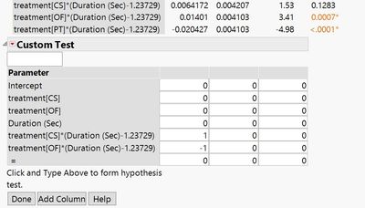

Thanks for the clarification. I've attached another window below. If I understand correctly I have set up the first contrast (CS*Duration-OF*Duration=0) correctly. I thought the negative coefficients were supposed to let me test against the third categorical effect (PT*duration), you can see that in the expanded estimates but not in the set up for the custom test. How do I test against PT*Duration?

I believe that you set the coefficient for the first estimate equal to 1 and leave the rest 0. You can check the result. The Value should be the difference between the estimates that you are comparing to null of zero difference.

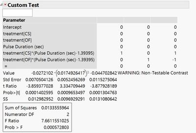

Still don't think I'm getting it right.
First, I'm still getting a non-contrastable warning (see below).
Second, It appears that by making the second coefficient -1 for the CS*Duration -(-OF*Duration)=0 cross adds the value of the two which is not what I want. It ends up being -0.0447.
Third, if I am trying to compare PT*Duration to OF*Duration (OF*Duration-PT*Duration=0) the Value should be 0.00777 instead it is just the value of OF*Duration (0.0174926). So leaving the coefficient at 0 does not seem to work.

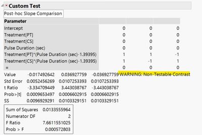

Thanks, this is the solution I'm looking for and the results makes sense. The only final hiccup is I am still getting the "Warning: Non-Testable Contrast". Is that saying the joint test is Non-Testable or a one of the contrasts is not testable? When I run the pairwise contrasts independently I don't get the same response.
Re: Fit Model Custom Test Coefficients
The warning is about the joint test. There are not enough degrees of freedom available for the number of joint tests.
