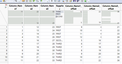

the problem is that the formula doesn't work because the column name appeart in the column info->Formula as "Column_name" or it should be "Column-name"n, I trid to use Name() function but it did not work :(

Right,
But for example after the script compiled, if i take one column to see what its formula looks like I've got this :
If(:Supplier == "FIRST",
	"Column_Name" + 4,
	If(:Supplier == "SECOND",
		"Column_Name" + 5,
		If(:Supplier == "THIRD",
			"Column_Name" + (-10),
			"Column_Name"
Which doesn't work because it should be like that to work :
	"Column_Name"n + 4,
		"Column_Name"n + 5,
			"Column_Name"n + (-10),
			"Column_Name"n
How do I modified my script then ? Thank you :)

Re: Finding the correct format of name jsl
Here is the data
