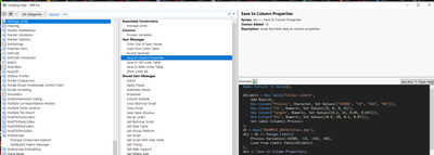

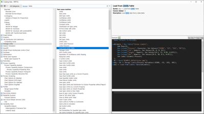

Manage Spec limits is one platform which has quite a few features which aren't being captured by action recorder so you might have to take a peek to Scripting Index and Manage Limits
This most likely gives quite good of an idea what you can do. Then you can create a custom step in workflow builder and utilize this example. You might also want to see all options for the Manage Limits (category on the left and filter empty) to see how to set those specification limits after they have been loaded
