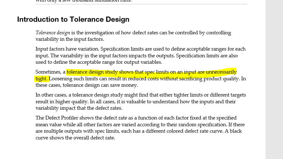

ToleranceDesign.PNGHi Mark,
I was going through the book manual on the profilers and came across this, what I am looking for is that with the current response specification limits what are the factors limit which I should use whereby it will not be to tight and too loose causing to many failures

Re: Finding the allowable limits for a factor to ensure low defect rates
We are 'going around in circles.' You keep telling me that you want to determine the factor ranges that will maintain process capability. I already explained how to perform this analysis. I directed you to chapter 8 in the Profilers guide, which thoroughly explains and demonstrates the Defect Profiler in The Simulator. What is not clear? What do you not understand? What is the specific problem that you are having?

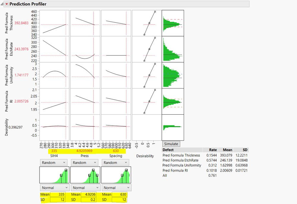

This is the experiment that I am currently conducting, the method that normally we use is that we use the defect log rate to find the best settings for the factors, but what I am looking for what is the best SD for each factors (eg in this example my normal SIH4 SD = 12, Press SD = 0.2, Space SD = 12. And we know that the defect rate can even be reduce more when we tighthen the SD for our factors. So what I am looking for is what is the SD that I have to run for all these 3 factors in order to meet the specification limit for all my 4 response (Thickness, Etchrate, Uniformity, RI)
I know that we can 'manually' adjust the SD 1 by 1 to see what is the SD to achieve a 0% defect rate, but is there an automated way to do this
Hope this explains my question/problem
There is no automated procedure. The idea is that the engineer / scientist uses this tool to set up different scenarios and evaluate capability / defects. JMP cannot know how easy or hard, cheap or expensive it is to control the factor levels.
